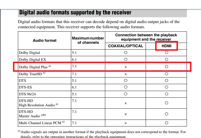

just_sony
hey..
yes the pb is AVR.. my AVR is not supporting ARC DD+ sound...only over HDMI...
wbr.
