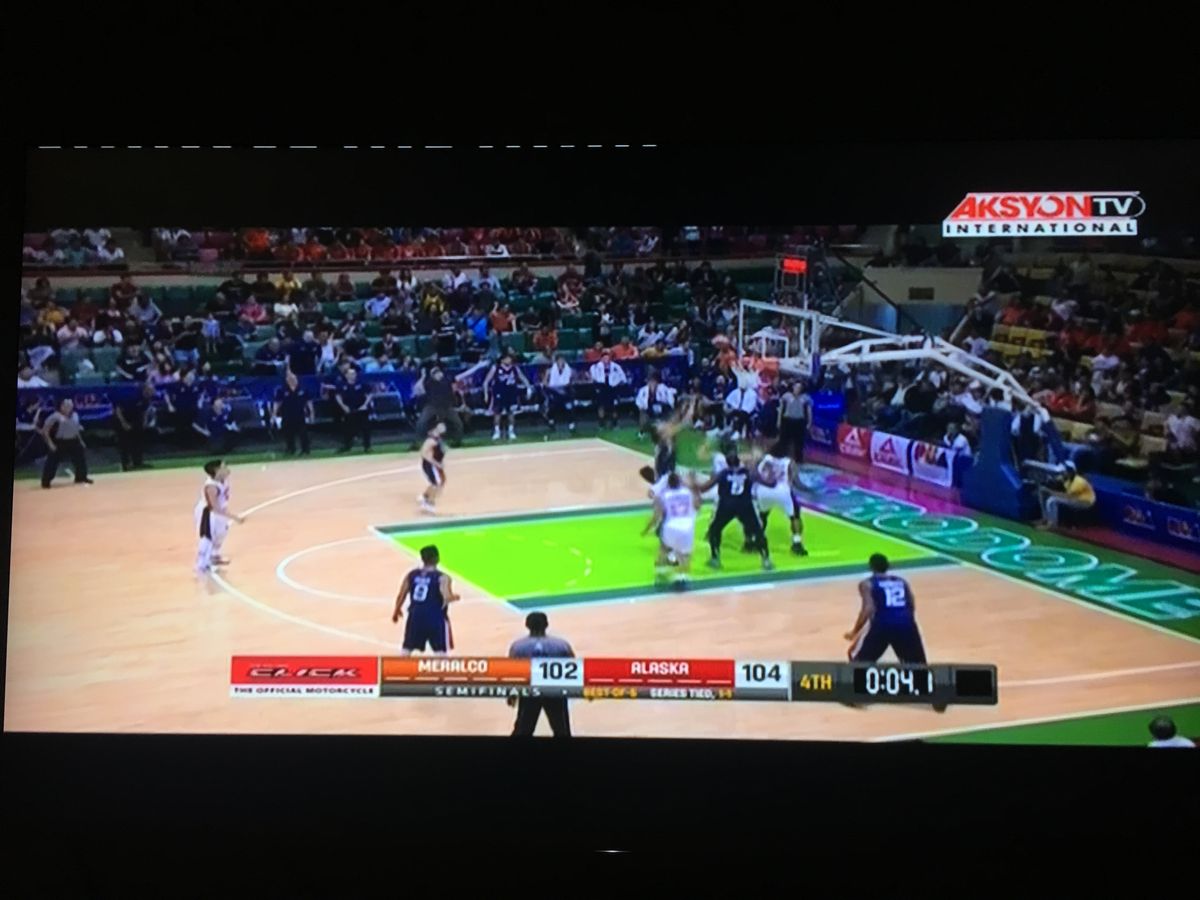

white lights at the top of the screen
why there are lights at the top of the screen? can anyone help me about this.
2 REPLIES 2
IamNic
Hello @neilcortez,
to me it looks like part of the video image.
Is it there if you open the menu or switch to another source?
- Nic
dutchice
Hi @neilcortez,
The picture you have attached is most surely from an attached HDMI source device. The white artifacts you see on the top edge of the image can easily be corrected if you change your Display Area setting from [+1] to [Normal] on your TV. Or if you have it set now on [Normal], then by changing it to [-1]. You can find the Display Area setting as follows:
HOME > Settings > Picture & Display > Screen > Display Area
Cheers,
Dutchice
