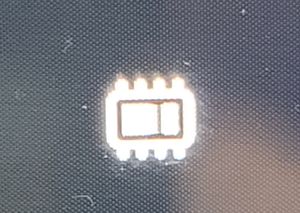

However, after five minutes, the camera goes black and shows a strange icon.

Hey @THS_Creation
As it's an officially incompatible third-party accessories, it may be corrupting the internal memory of the camera or causing it to misbehave. (This warning icon indicates an issue with the internal memory).

Sorry for tyr late reply. Thanks for the info.
I won’t be connecting these items together anymore.
