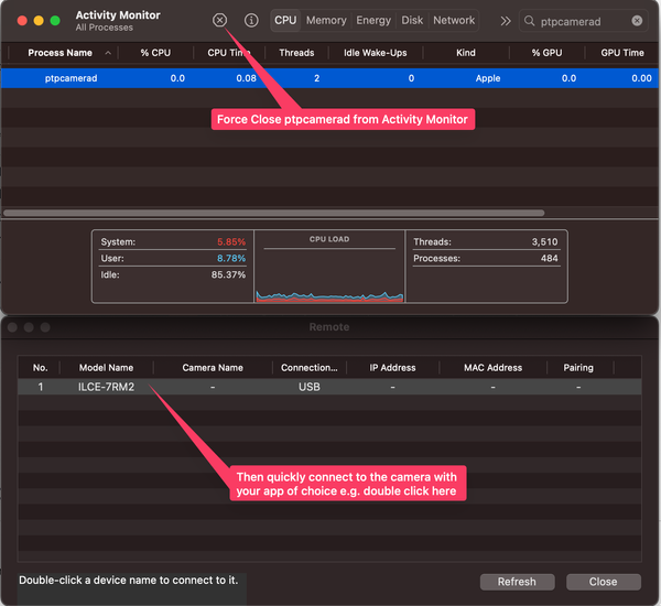

I have another potential workaround that's working for me where none of the others above were:
Before attempting to connect to the camera (from Imaging Edge Desktop, Zoom, Teams etc), force stop the ptpcamerad process. In my case, this system daemon appeared to be using the camera and preventing other apps connecting. The steps to do this are:
  • Start Activity Monitor, either via typing it into Spotlight, or going to Applications / Utilities
  • From the CPU tab, type ptpcamerad into the search box
  • Now have the app you want use with the camera ready to connect. For example, in the case of Imaging Edge Desktop Remove, have the USB devices list visible
  • From Activity Monitor, hit the (X) button and choose Force Stop
  • Now quickly switch to the camera app and connect to the camera
With luck, the app can now connect. And, on my machine, so long as the camera remains on, apps can reconnect to it without needing to do the same trick every time. The OS appears to restart the ptpcamerad process within a second or two. I'm not sure what impact killing this process might have on other apps so do this at your own risk!

This solved it for me! Thank you so much... now to that Zoom meeting
