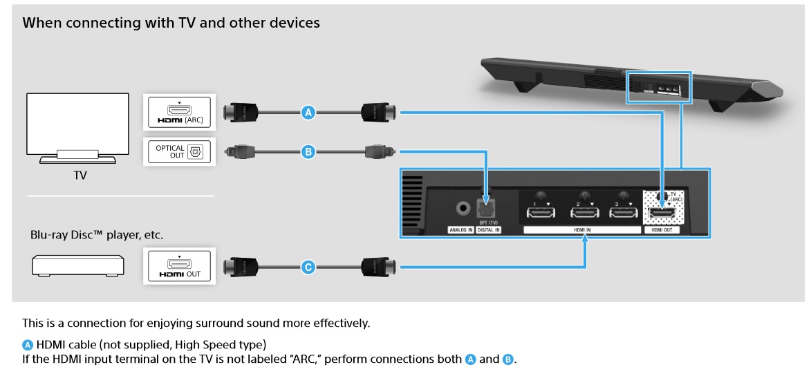

I bought this system about a week ago and I love it but I do not know how to set up my ps3 and other equipment so sound comes from the system but I still have visuals on tv. It says I can connect the ps3 directly into the sound bar but where would the visuals come from because I would be using the ps3 hdmi port to connect the sound bar leaving me no connection to tv. The manual isn't very helpful and hopefully someone can guide me.

Yes you can connect your PS3 to the CT370 soundbar.  To set it up, you connect it as follows:
  1. Connect a HDMI cable from the CT370 - HDMI OUT (ARC) port, to the TVs HDMI ARC port.  Assuming your TV has a HDMI ARC Port (if not, you also need to connect an optical cable between the two).
  2. Connect a HDMI cable from the PS3 to the CT370 soundbar.
HDMI Cables support both Audio and Video, therefore both audio and video goes into the soundbar, the audio out outputted, whilst the video is transferred to the TV via the HDMI connection to the TV.
See Diagram:
Hope this helps.
See Diagram:
Hope this helps.

But since everything is connected to the sound bar with video transferred to tv, how would I know what channel to select to display it accordingly?

Hi there
On the TV, you select whichever HDMI channel that you have connected the soundbar to (ie HDMI 1-ARC).
On the Soundbar, you press the 'input' button on the soundbar or remote control repeatedly until you cycle through to the correct source the device is connected to.
Hopefully this makes more sense?

So say I have ps3 connected to hdmi 1 and a sky box connected to hdmi 2, if I change the input to hdmi 2, it will display both sound and video for the sky box?

Yep.  :slight_smile:
In relation to your scenario, If the PS3 is connect to the HDMI 1 port on the CT370 AND you select the HDMI 1 input, the sound will be outputted via the soundbar, and the video will be fed up and displayed onto the TV (using the HDMI connection between the two).
Flicking to the HDMI 2 input on the Soundbar, the Sky box should then do the same (ie sound via soundbar, and video to the TV)
Hope this explains things a little better
