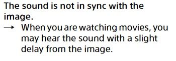

Hi there
I love Sony manuals
- This is in their manual for your soundbar under the troubleshooting section:
Not very helpful hey !
