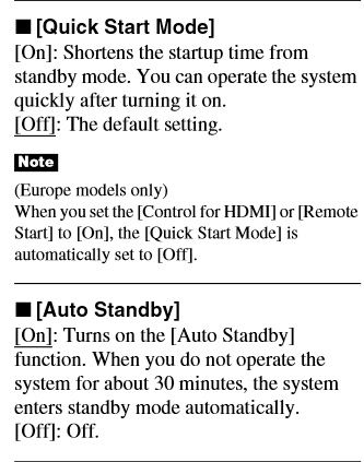

4. Can't get to grips with why it goes into standby or how to wake it up etc. Obviously now irrelevant since its stuck.
Hopefully the following explains things more:
