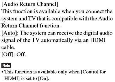

According to the manual (Page 56 : HERE😞
See the NOTE part, ensure that Control for HDMI is set to ON.
If you still cannot see "Audio Return Channel", look under System Settings > HDMI Settings - It should be there. If it isnt, double check that your model is "BDV-E370" and have a look at the back of the bluray player, where the HDMI port is, and it should have it labled with the letters ARC on it too.
