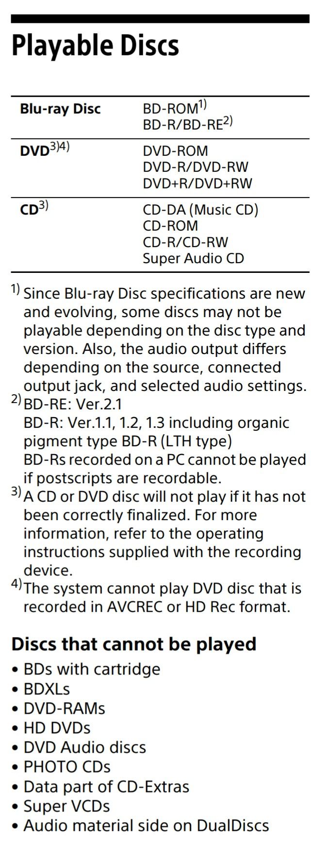

Hi there
I guess it comes down to the types of discs you are using. The Sony Bluray player supports the following:
Can you confirm?

It appears that I am using the correct BD-R.
I have tried Verbatim and Panasonic discs.
