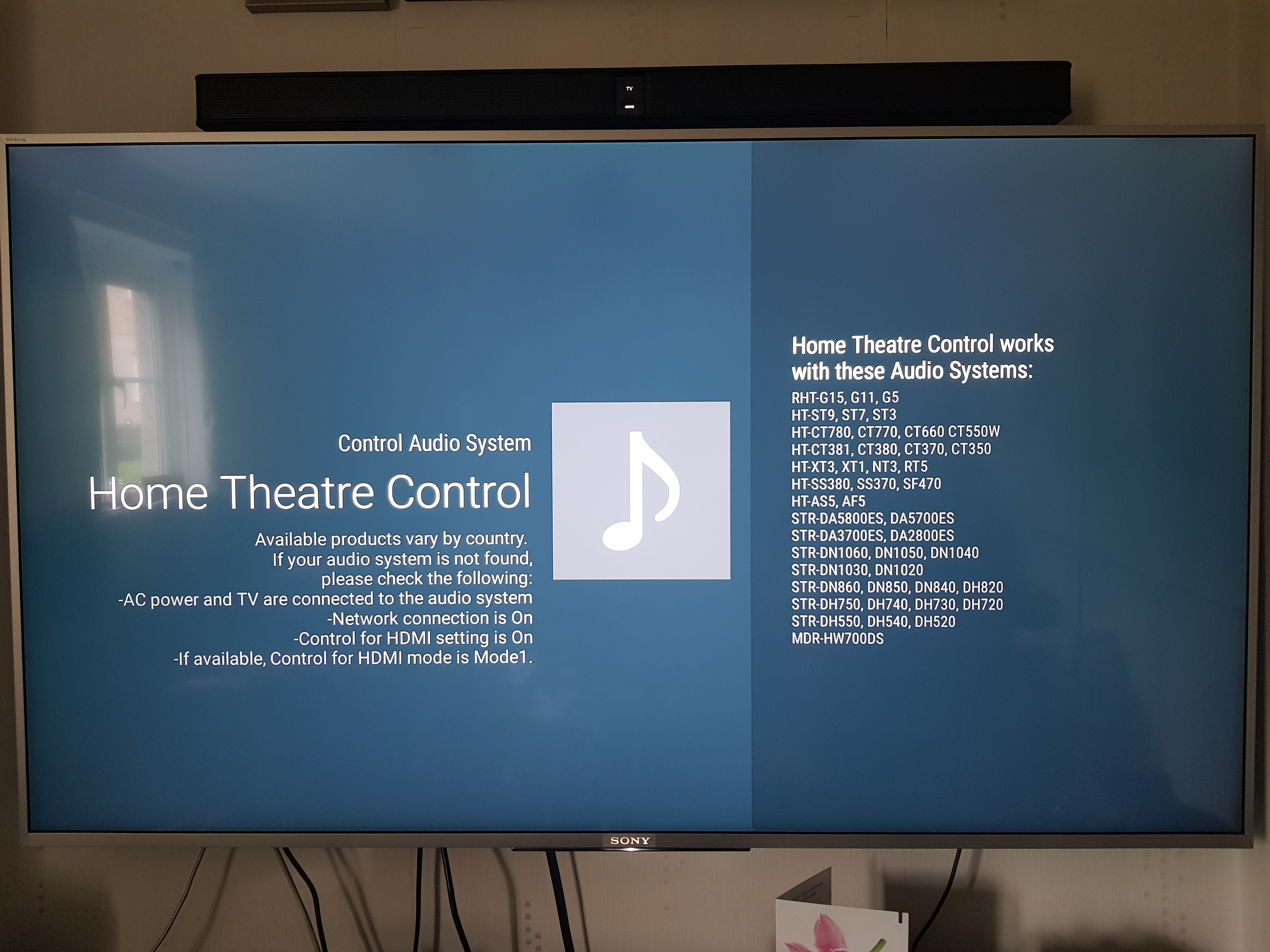

Hi,
I have looked for those settings before but nothing comes up which allows me to adjust any settings from the home theatre control tab.
Hi there
Thanks for the photo - ive added it to my records so I now know what devices its compatible with
In regards to your problem, as I cannot replicate it and there doesnt appear to be any setting adjustments that you can make on your end - I think the best thing to do is for me to escalate this to Sony Support. Please ensure that you have correct contact details in your profile as Sony will be in contact with you early next week (seeing that its late Friday now).
