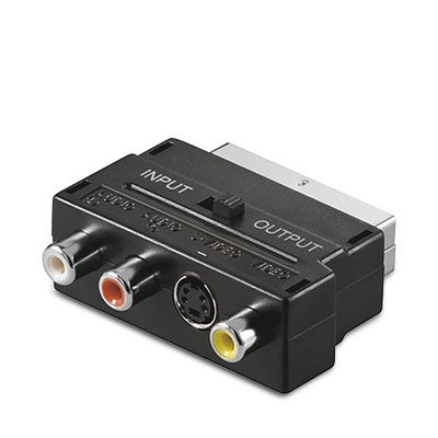

Since you already confirmed that the grabber ususally works with other devices, that is most likely the reason. I suppose your other devices directly output Composite video + Chinch (yellow/red/white) as oppose to the Sony VCR for which you need to adapt "Scart" to this connector.

if I understood you correctly, you connect the Hitachi VCR via Composite-video+Chinch (Yellow, White, Red), since it features said output directly on the device, while for the Sony VCR you have to adapt Scart to Composite-video+Chinch.
Did I get that right? 🤔
If so, then the adapter you are using to plug into the back of your Sony VCR is directional and would only work on the display-side (e.g. TV) but not as an adapter on the device-side (as you use it here).
There are different Scart to Composite Video+Chinch adapters, some only work as input, some work as output, others even have a switch on the side to use them for both applications - yours seemingly doesn't have such a switch, so it could be just for input on a TV and therefore the reason, why it doesn't work connected to your video grabber.

With the Hitchaci, I plug in the scart lead into the VCR, and I am doing the same with the Sony. The scart lead connects to the converter/grabber via the red, yellow, and white cables (which are on the other side of the scart plug as in the screenshot). The converter attaches to the PC via the USB lead.
