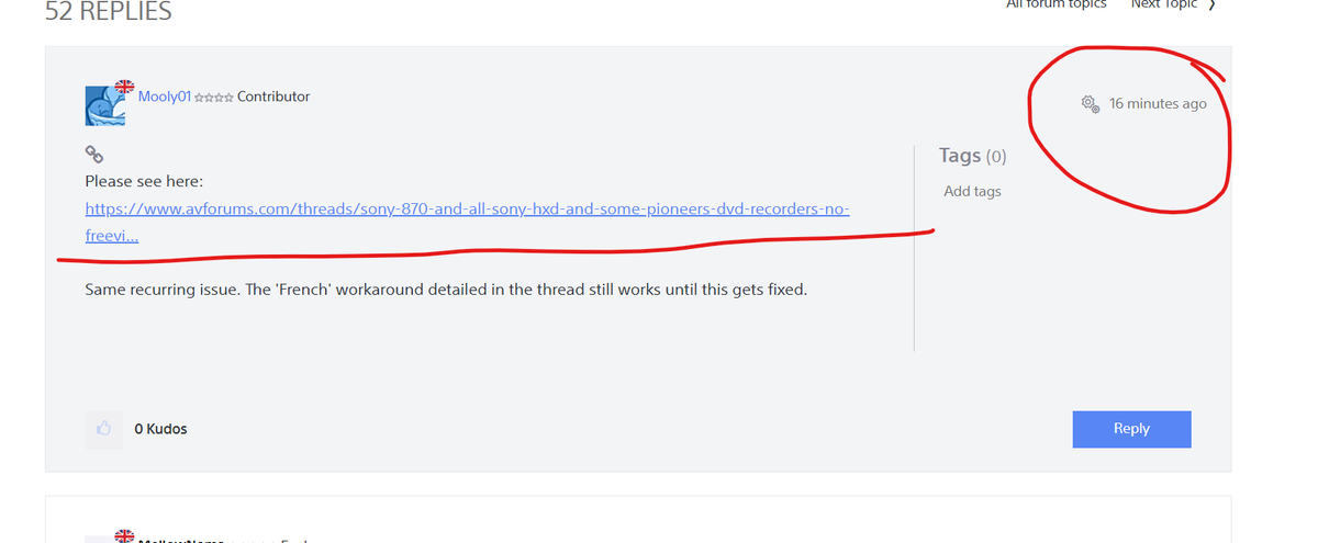

Please see here:
https://www.avforums.com/threads/sony-870-and-all-sony-hxd-and-some-pioneers-dvd-recorders-no-freevi...
Same recurring issue. The 'French' workaround detailed in the thread still works until this gets fixed.

Its nothing to do with maintenance. You have clicked an old link.
This is what I posted a few minutes ago. Its the post above yours:
MellowNoma
@Mooly01- I don't see how I spotted an "old link", from an active webpage for the Winter Hill mast and their scheduled updates that quotes work being carried out from 24th June 2024 - unless you call a date that refers to work starting 3 days ago as an "old link" ?
