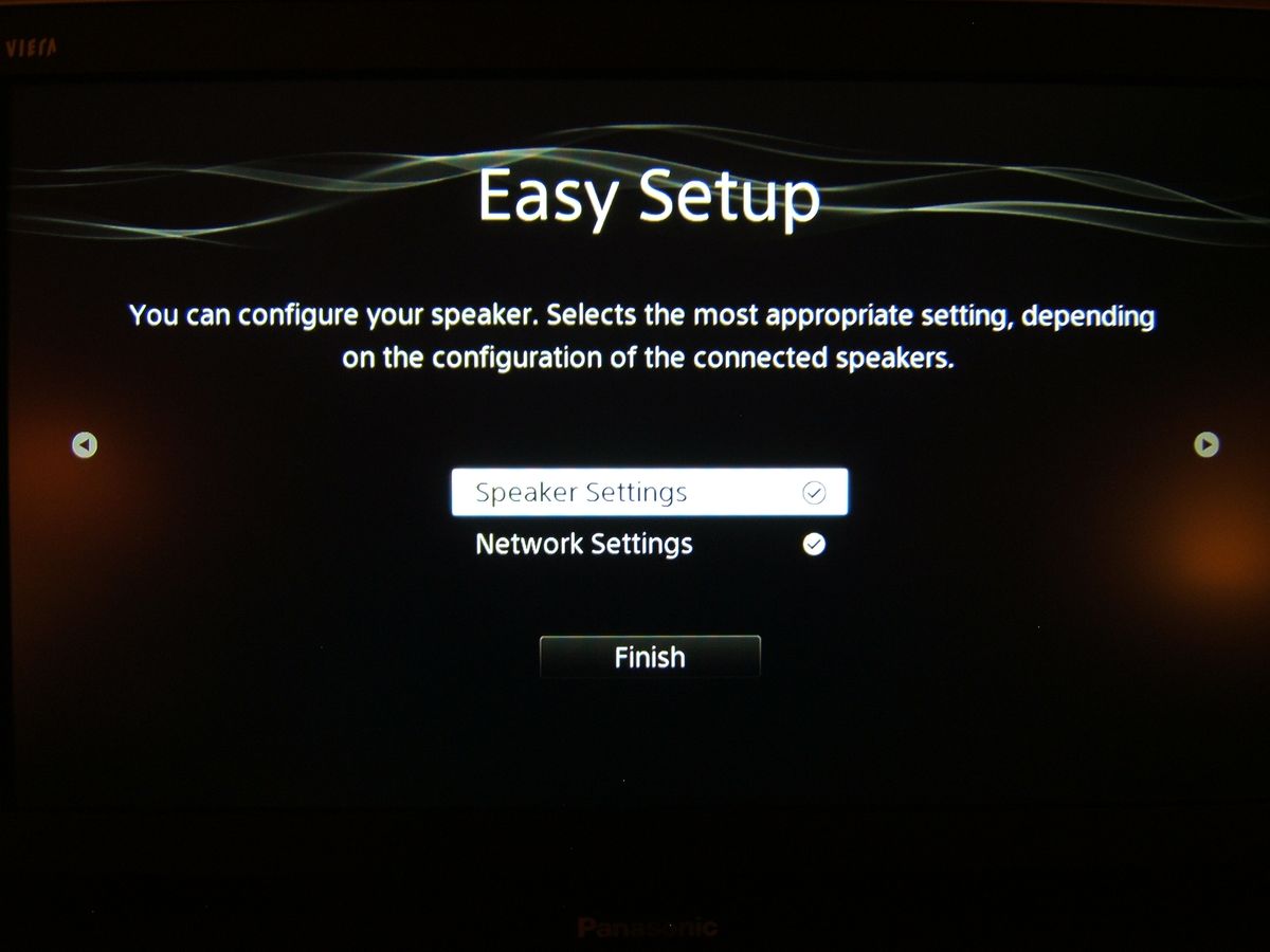

In this first image we have the Easy Setup Menu which gives the options for setting up your speakers or Network

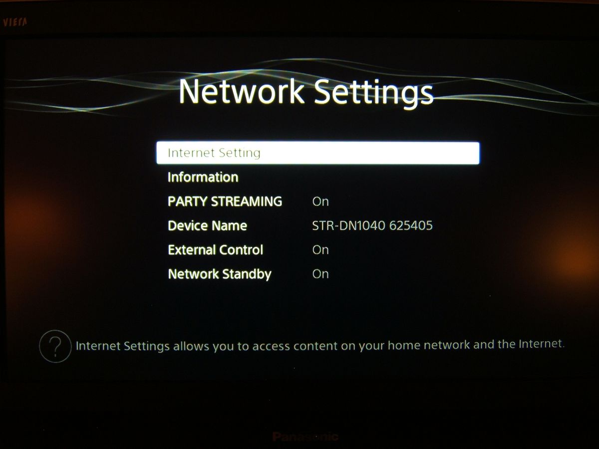

Selecting Network Settings in the above menu shows this first menu shown below

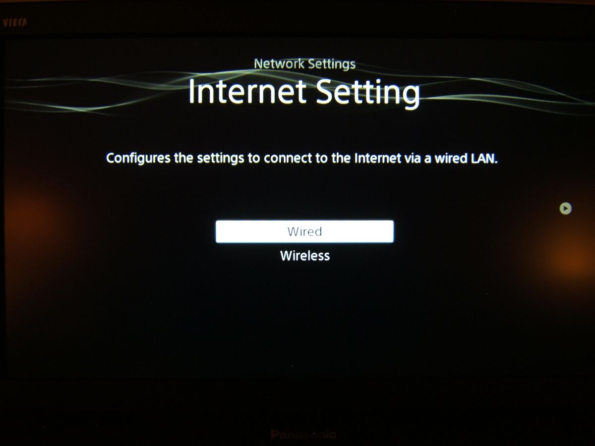

Selecting Internet Settings in the above menu takes you to this next menu below where you can choose between a Wired LAN connection or Wireless

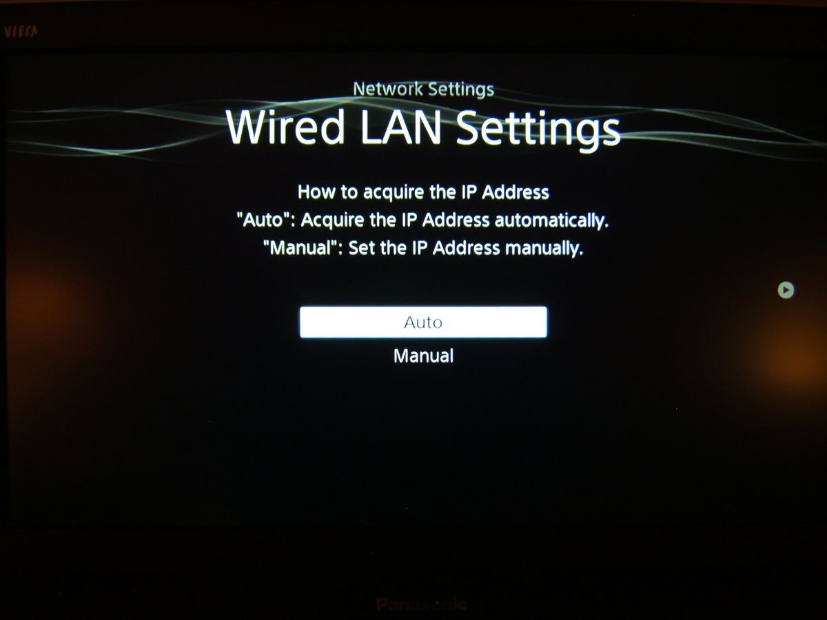

Selecting the Wired LAN connection method above takes you to this next menu which gives the user the options of automatically acquiring the IP Address or to set it manually

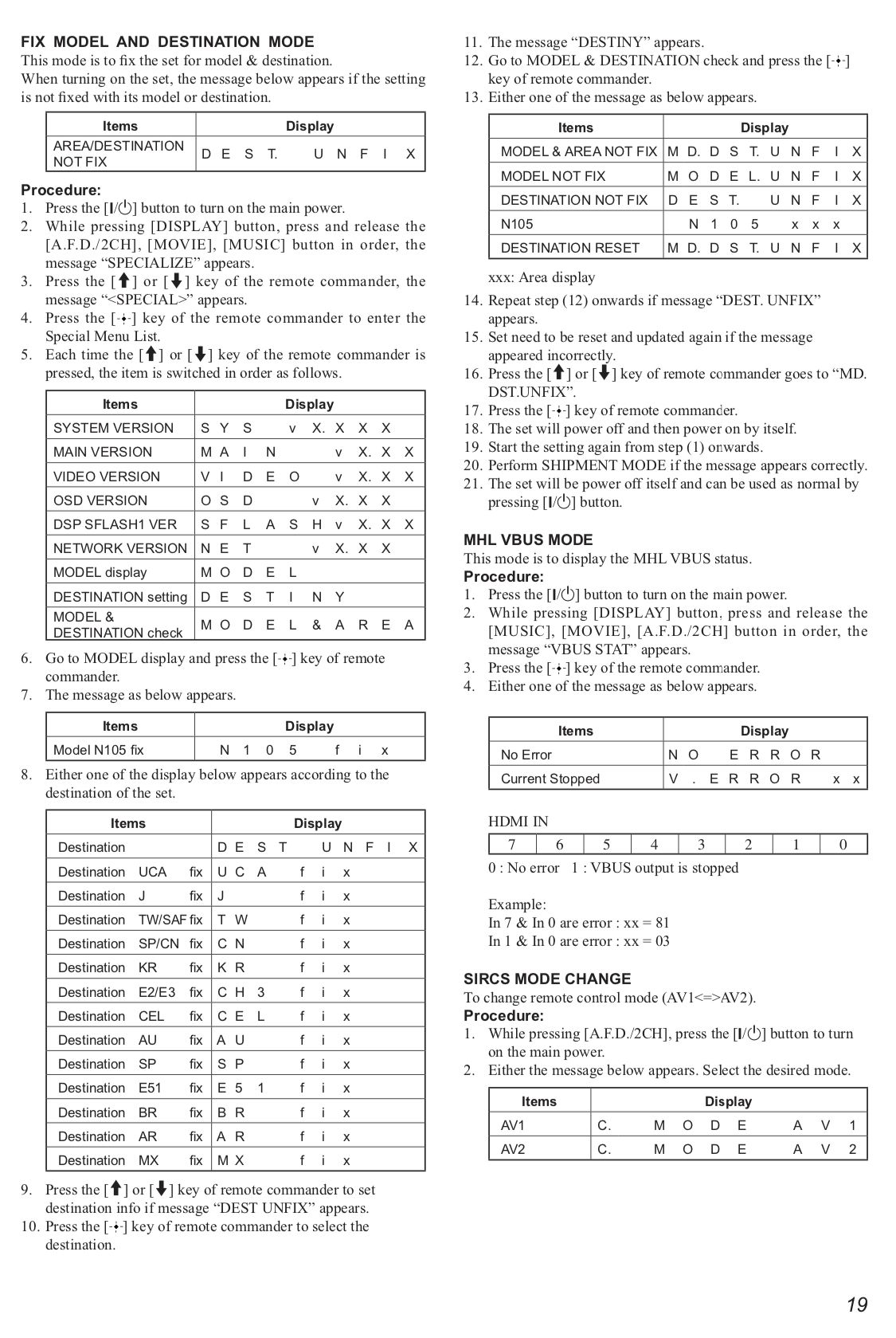

Hi, the menu is disabled because it cannot pass the EU regulations for networked standby power consumption. You can change the region via the service menu but you’ll lose the FM RDS function. See the service menu excerpt
