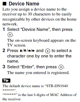

BTW, I don't know if this is relevant but as found in my manual under 'Network Settings' it mentions the following....., maybe @joewbarrell needs to set this on his device also?
