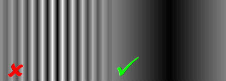

Firstly, we need to check for the correct picture size. In general, TVs will enlarge the provided signal slightly which results in a picture that’s not as sharp as it could be - you might be able to notice this by looking at the resolution stripes which show a kind of moiré effect. To see the true picture size, go to ‘Settings’ > ‘Display’ > ‘Screen’, then set auto display area to ‘Off’ and display area to “Full Pixel”. Now you should see the full arrows in each corner and the moiré in the resolution field should have disappeared.
