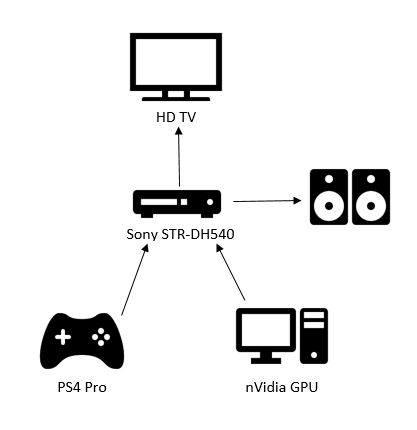

/edit: OK, I created some schemas. First, the current setup is like this:

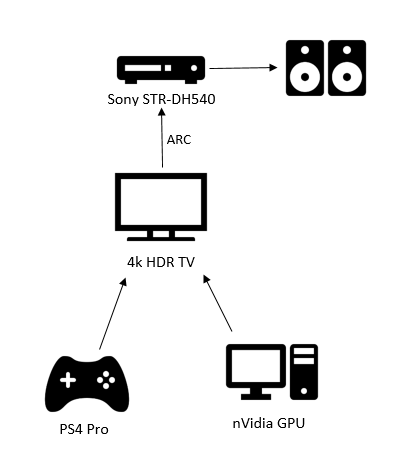

If I want to upgrade TV to 4k HDR model but not spend extra money for a new receiver, I need to change the setup to this:
Is that correct? Does anyone know if PC GPU will work this way? I know PS4 definitely will.
OK, I can clearly forget that plan, just tried ARC on my current TV and it's LPCM 2.0 or DD5.1 ONLY, yes, not even DTS passthrough, definitely not usable for PC connection. Man, I WILL need a new receiver, jeez. Can't believe we still need those ugly big boxes just to have some sound, it's like we are forever stuck in nineties....
