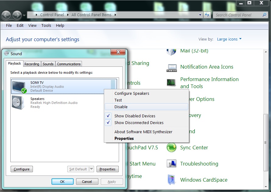

Hi there
It seems Audio is still being outputted to the TV still.
Ensure that Audio is disabled in windows too, and not just the Nvidia's Control panel.
As per screenshot below:
Sony TV does not show in there, all that is there is the 2 Realtek devices, one is speakers which says not plugged in and the other is the digital output which is the default device (the optical out from PC to amp)
