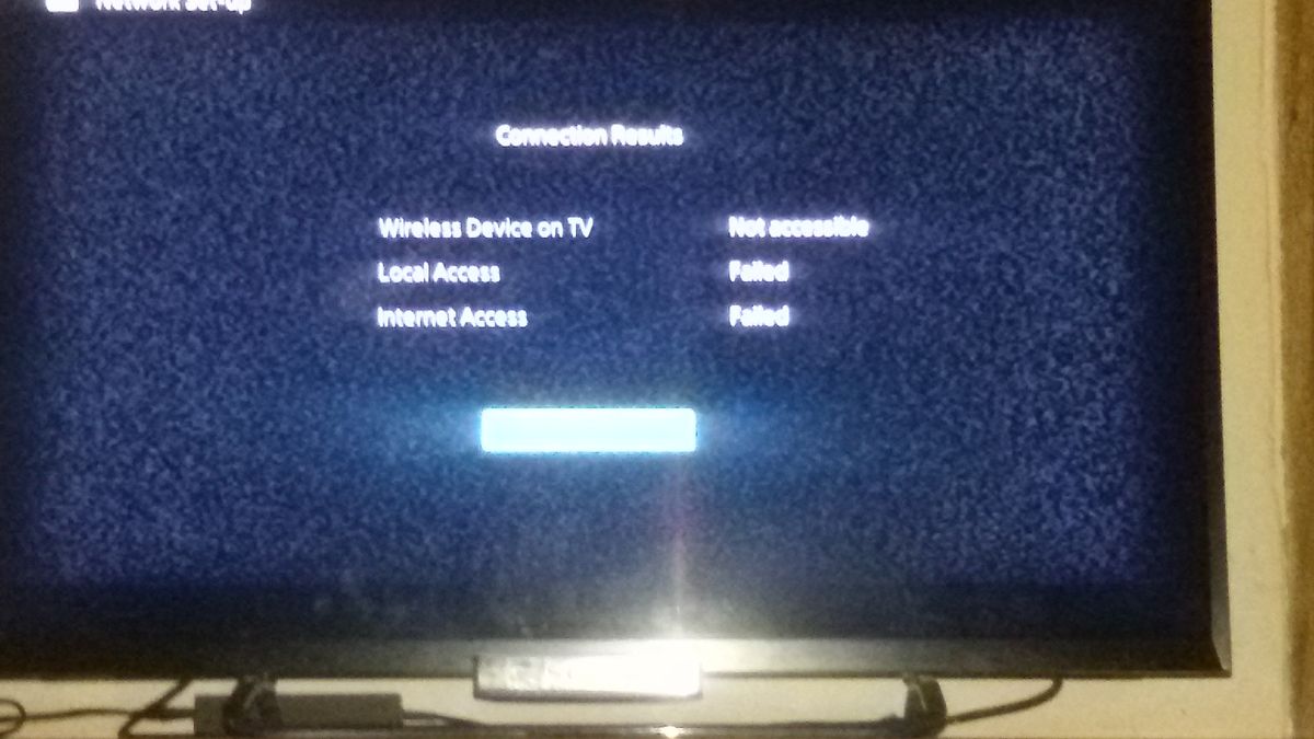

thank you for your interest on this issue.as i said in network settings no built in wifi menu...sometimes it can be found (daily)and sometimes not(same day).for your inquiry I am posting some pics.hope this will help!
