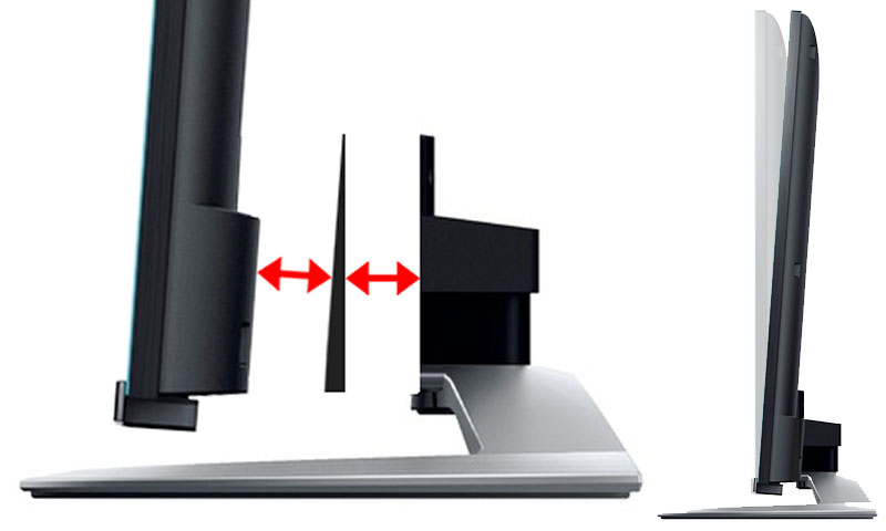

I did just consider this as a solution to the problem. I have no idea whether the back of the TV could handle the stress caused by the tilt though.
I looked at what angle would be required to correct an 8 inch vertical shift over approximately 13 feet. It worked out about 3.3 degrees. A shim that fits between the set and the stand, at a slightly greater angle, i.e. 4 degrees in this case, would negate that effect. Over a 6 inch length, the plate would have to be about half an inch thick at the bottom to work.
This is where a 3D printer would be really useful, as I could model it in 3DS Max, and print it out to test it. It would probably need slightly longer screws at the bottom, so they would pass through the plate and then fit securely into the TV.
