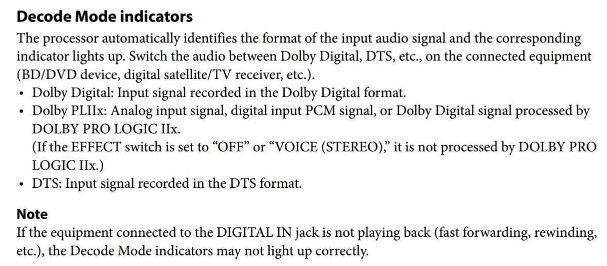

I have this TV and today bought a set of Sony Wireless Headphones
MDR-DS6500.
Issue I have is that when using the apps on the TV (Netflix, Iplayer), it is not transmitting Dolby Digital to the receiver. I have tried also testing it with TV channels on the TV's tuner and no DD there either (despite the EPG confirming programmes are being broadcast in DD).
I am flumoxed as to why. I am getting Dolby fine when connecting my Tivo box direct to the receiver. Haven't tried my Bluray Player but presume again I will get DD if plugged in direct.
Other connected equipment is a HT-XT1 sound stage (via the HDMI ARC input of the TV).
Can anyone clear this up for me? Pretty sure it's not a fault of the receiver for the headphones as it can receive DD from other sources.

When changed to Audio System, I am now getting DD via my Headphones AND the HT-XT1 simultaneously!!
I've ordered a three way optical cable splitter so I can have Bluray, TV and Tivo all connected to the headphone receiver at the same time. I *think* that should solve the problem as going direct from device to the receiver seems to carry DD no problem.

Right, I have found a solution.
The aforementioned optical splitter means I get DD from my TV's apps, it's Tuner and also my Tivo box.
The only fly in the ointment is that my Bluray player only has a digital co-ax out, so I would need to buy a co-ax to optical convertor for that. I probably won't bother as the player rarely gets used and I can still get Dolby Prologix IIx via the headphones with it (on the rare occasion that I will watch a disc).
