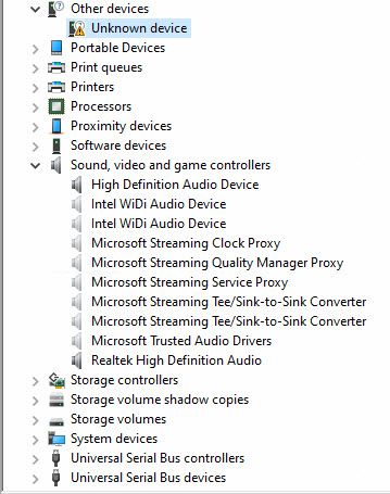

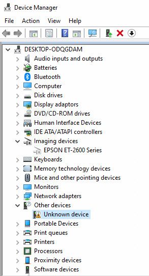

My friend has a Vaio Product Name: SVF1521C2EW which I updated from Windows 8.1 to Windows 10 and replaced the HDD to a SSD two or three years ago. Every thing works as normal except that he has now tried to use the web cam but there it is not showing in Device Manager!
Now with the COVID-19 lockdown he needs to use Zoom but is unable to with the laptop because of the web cam not showing.
Where can I download the web cam driver and any other web cam utility to be able to use the laptop camera?
Device Manager below;

I believe the camera uses generic Windows drivers so I don’t think it is a straightforward driver issue.
If you could give details of the hardware IDs of the two unknown devices in Device Manager, that may give a clue.
The commonly omitted driver when a hdd and OS has been replaced is the ‘Sony Firmware Extension Parser’ abbreviated to SFEP driver. You could try installing the most recent version from the Sony Support page for that model. SFEP is Not OS dependant so just try the latest available here:-

By the way the Device Manager does not show a web cam in Imaging Devices and only one unknown device.

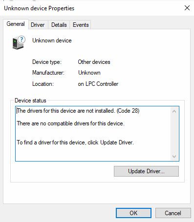

Hi @Blencogo I have downloaded the Sony Firmware Extension Parser (Windows 8.1 64bit) installed it, or so I think as it just extracted EP0000600937.exe 2020-05-19_15-51-07.jpg2020-05-19_15-51-07.jpgfor a second and nothing else showed, restarted the pc but nothing shows in Device Manager for the camera or the unknown device.

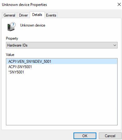

The unknown device hardware ID is as shown below;
2020-05-19_14-38-05.jpg2020-05-19_14-38-05.jpg2020-05-19_15-02-11.jpg2020-05-19_15-02-11.jpg
In the HID there is no entry for the camera;
Don't know what else to do to solve this issue.

The good news is that the unknown driver is definitely the SFEP driver. SNY5001 is the hardware ID for this driver.
I’m not at home and can’t get to a PC at the moment. I’ll look this evening.
From memory there are two different ways to install this driver depending on the Vaio model. The simple way is to download the driver to a download folder and then run the .exe file as an administrator. The second way is more complex and requires installation from inside Device Manager, and installing the driver for the unknown device and choosing ‘Have Disc’ and pointing to the downloaded file location. I’ll need to check this when at home.
