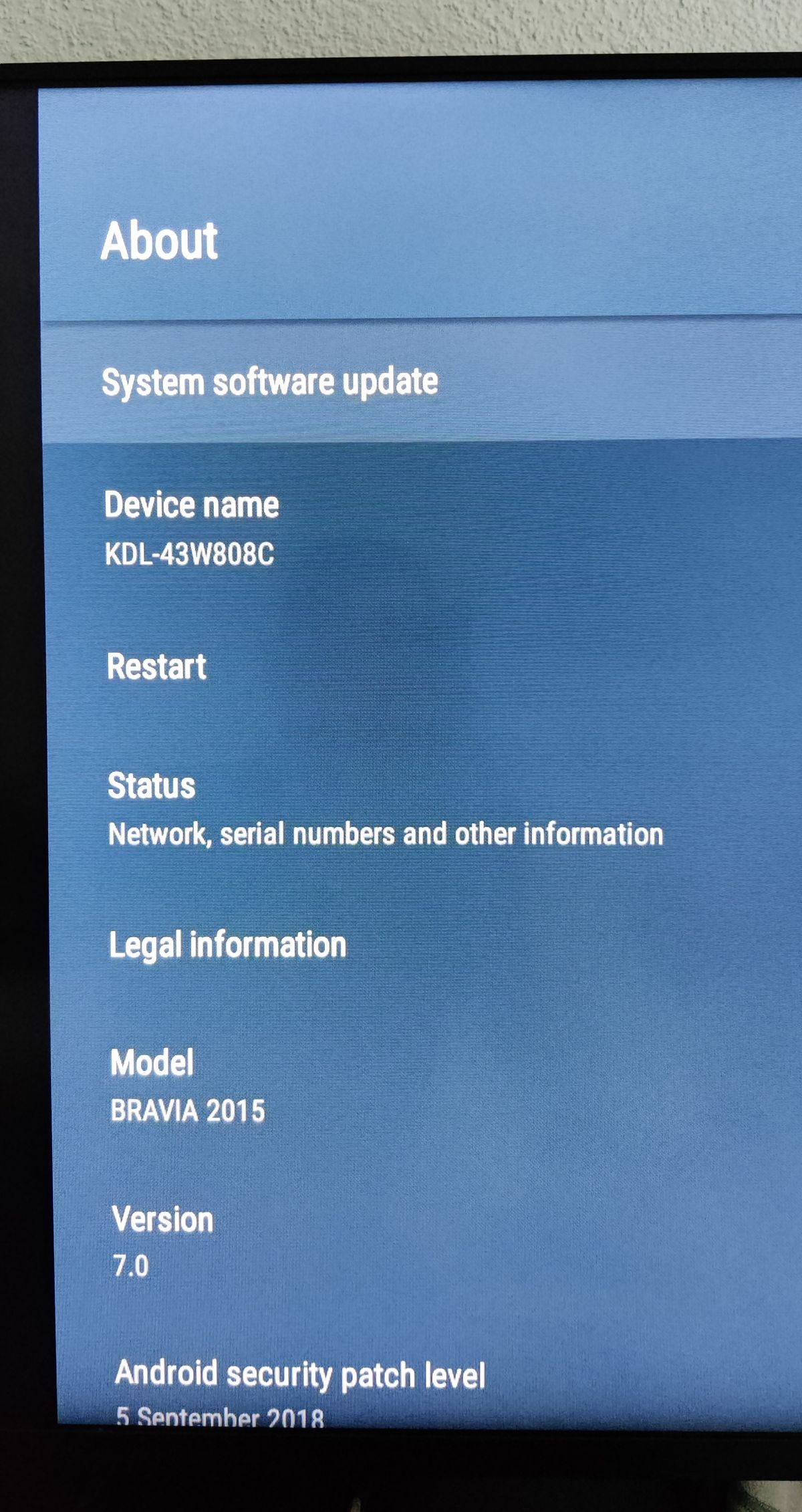

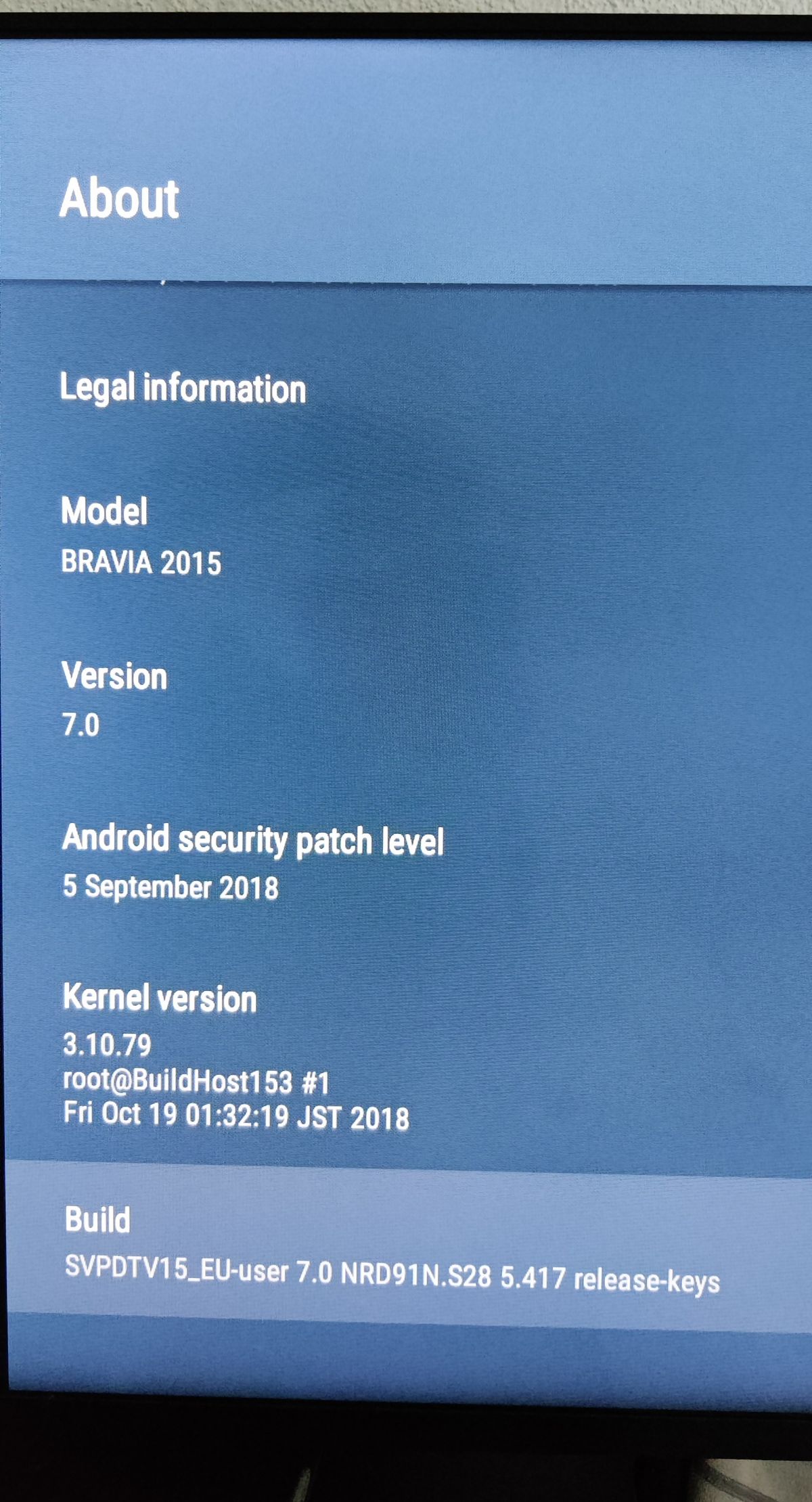

Hi @Anonymous ,
Before my old motherboard died, I had the same layout for IU. This is Android 7.0 Sony v5.417.
Indeed, when I installed the motherboard it had Android 5.1.1 and the layout was a little bit different then the actual layout.
I'm very angry on those companies that I supposed to throw away my TV because the eMMC chip failed and they are not giving us posibility to reflash a new chip to replace it!
Here is the software version:
IMG_20220708_123614.jpgIMG_20220708_123614.jpgIMG_20220708_123633.jpgIMG_20220708_123633.jpg
