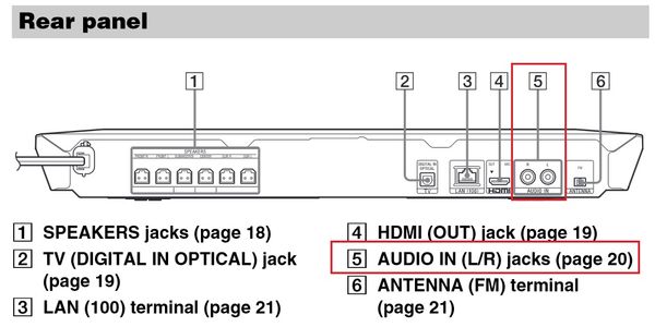

Hello
I am intending to upgrade my existing Sony Home Cinema system to a new BDV-E4100 Blu Ray system but need to first know if it will in fact allow me to conect my Sony PS-LX300 turntable as in my existing setup. The Sony turntable only has the standard 2 chanel Analog Audio Output on it so I need to know if the BDV-E4100 will support this.
If someone could please c;larify if this is possible to connect your help would be much appreciated.
Thanks
Gabe

Hi there
Looking at the manual, you would connect your turntable to the RCA inputs (number 5):

Hi there
Cheers
gabecooney
Thank you Quinnicus, you have been very helpful.
