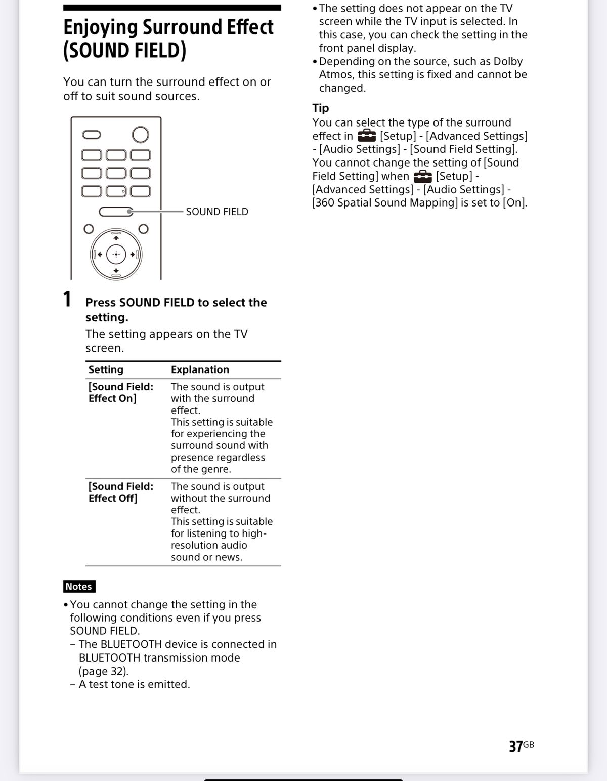

I recently bought the HT-A5000.
Yes the sound is ok but it's very front focused.
The upward firing speakers don't seem to add much at all.
Does anyone out there share my experience?

There’s a bit on page 37 of your paper manual about using Sound Field. Have you got this on?
Even better might be Advanced Settings/360 Spatial Sound Mapping instead, as mentioned there:-

As always, thank you for your assistance.
I've tweaked a few settings but no difference.
Still very front heavy which is a little disappointing.
I played a 4k bluray with Dolby Atmos. Same issue.
Maybe I was expecting too much!

Yes, that 360 option I was talking about turns out to require the rear speakers added, which probably tells you something about the limits of the soundbar’s psycho-acoustic tricks 😢
