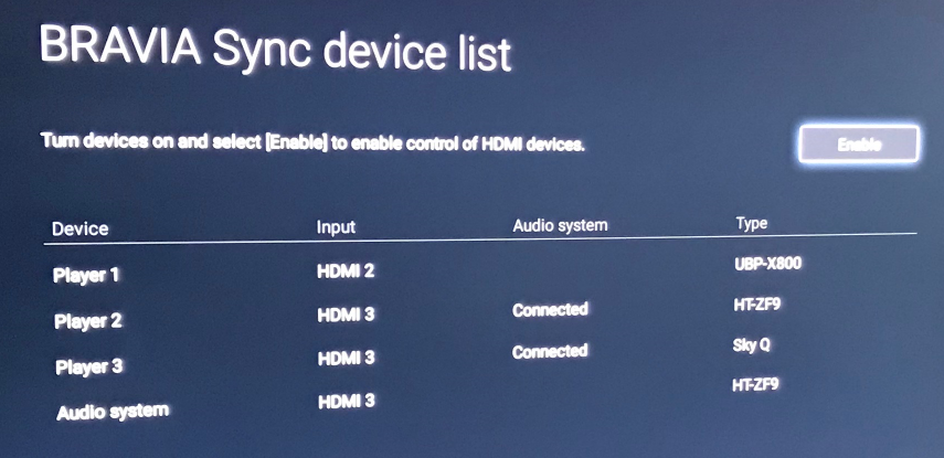

Try Home -> Settings-> External inputs -> BRAVIA Sync settings
Hi,
Thanks for the reply, how do I check to see if it is connected to the internet?
I've followed your directions as far as the 'Bravia sync device list' but the only devices shown are the Blu-Ray player (HDMI4) and the Sky Q ( HDMI3)

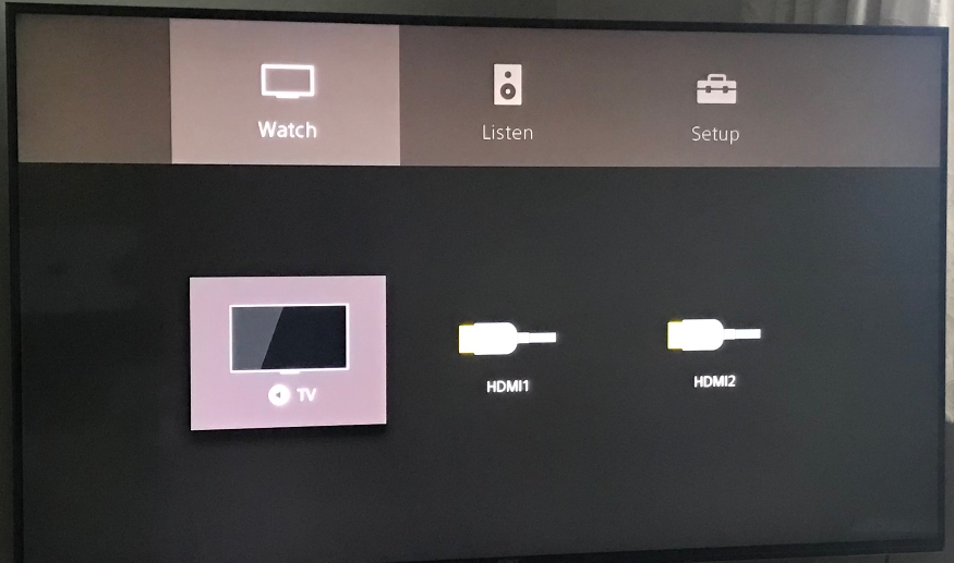

When I press 'Home' on the ZF9 remote, all I'm getting on the soundbar display is ' Home' ; should I be on a certain screen on the TV display?
On the 'Inputs' page , all that is showing are the Sky Q and Blu-Ray

@PaulinBont wrote:When I press 'Home' on the ZF9 remote, all I'm getting on the soundbar display is ' Home' ; should I be on a certain screen on the TV display?
Hi @PaulinBont
Yes, if it was connected correctly you should get the HT-ZF9 Home Menu on screen.
I'm only showing the two devices, and I have no idea how the installer connected up the various components, even though the soundbar is obviously working. Puzzling!
@PaulinBont wrote:I'm only showing the two devices
Hi @PaulinBont
Sorry it looks like you haven't got it setup correctly. Follow the Sky Q HDMI lead out of the Sky Q box. If it is going direct to the TV then use another high speed HDMI lead to connect the Sky Q box to HDMI 1 on the HT-ZF9. Then use the original lead from HT-ZF9 output to your TV.
You are looking to achieve Sky Q HDMI out to HT-ZF9 HDMI 1 in and HT-ZF9 out to XF9005 HDMI 3 (ARC) in.
