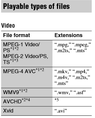

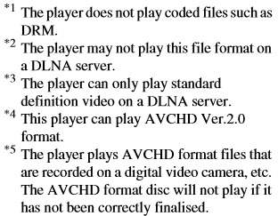

Hi there
First thing to do is download a program called Media Info : HERE run the program with the video file in question and determine the exact codec that is used.  Compare it with the chart below (supported video files for BDP-S390) to see if its supported.
Hope that assists anyhow
