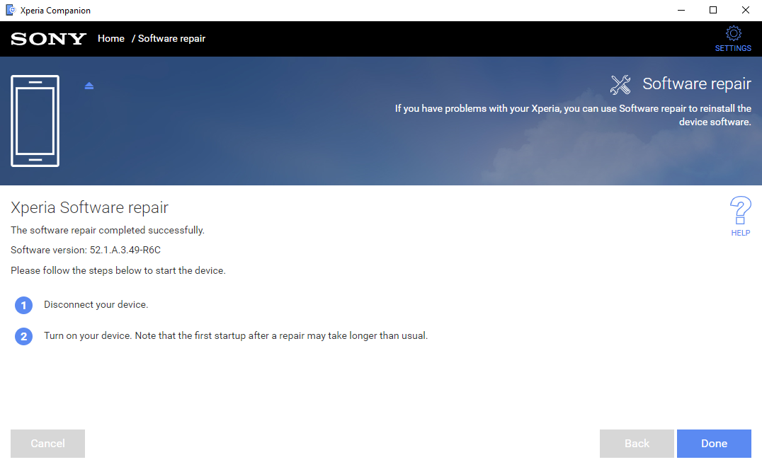

I successfully completed a software repair. Sorry for the long response delay! Will post any updates here on on my phone if there are anymore problems. If there aren't any then I'll mark your reply as the solution. ThanksSuccessful software repair of XZ2 CompactSuccessful software repair of XZ2 Compact

4 days after completing software repair the touchscreen has begun to randomly stop responding again. I can't see anything I did differently. I didn't download anything new. This is really annoying. It definitely isn't a hardware issue either since I can reliably fix the problem using the temporary solution I mentioned in an earlier post 🙁
