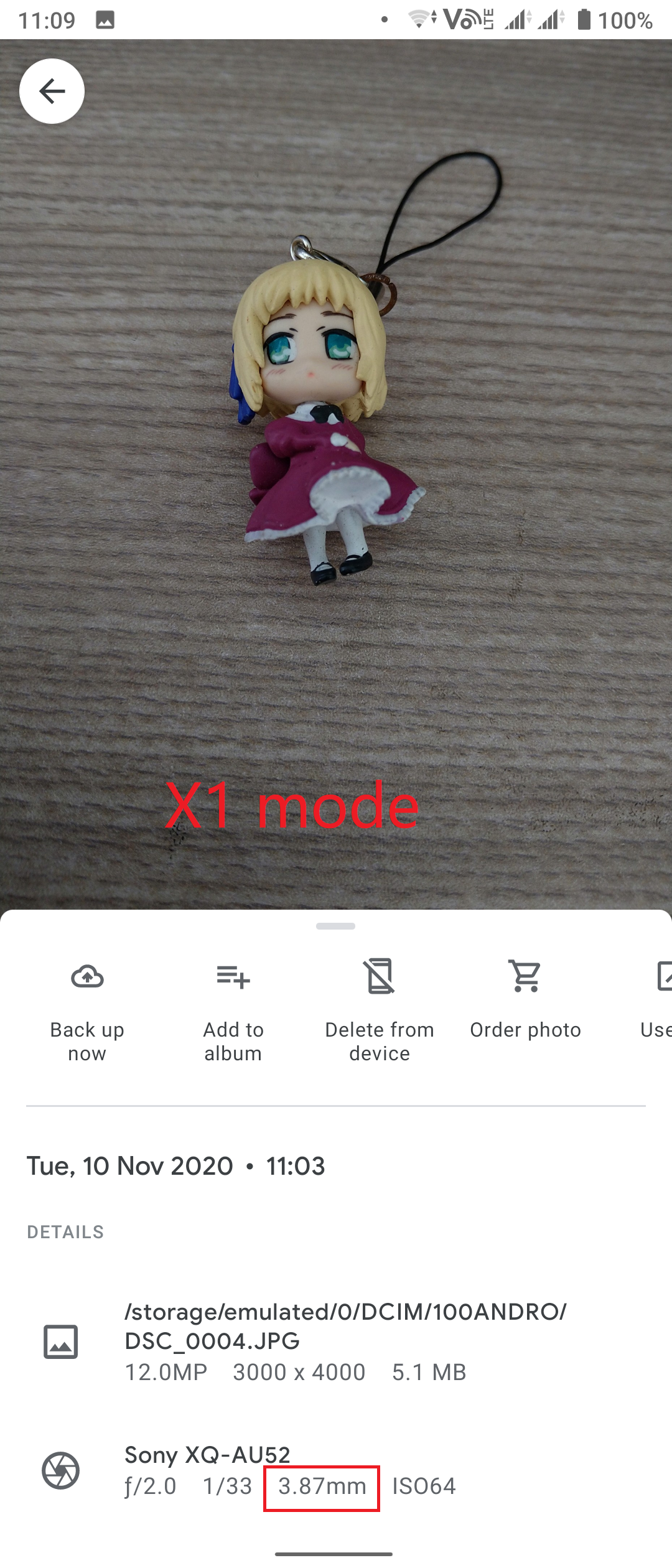

Second, as Sony introduced Xperia 10 Plus owns  2x optical zoom, 10 II uses the same CMOS, we should own this feature right?
For Xperia 10 II, from top to bottom, the first cam is 16mm Ultra-wide-angle, the second one is 26mm Wide-angle, the third one is 52mm Telephoto.
I tested on FW: 59.0.A.8.33,  on 2x mode. I think this picture should be taken by Telephoto cam, right? It is a 8MP sensor, but I got a 12MP photo.
So I tried to cover Telephoto cam with my finger when taking photo in 2x mode, as I thought, I got a "2X zoom" photo although Telephoto cam is coverd. This picture should only be taken by 26mm Wide-angle cam.
From my knowledge, xiaomi A2 & redmi 7A also uses imx486, but they don't support optical zoom. So Xperia 10 II never uses its Telephoto cam and it doesn't support 2x optical zoom at all. You could test on your own phone.

52mm cam only disabled in dark environment.

sjllls
Thank for these information.
52mm finally works in bright environment.
Yup, as you said, camera on Xperia 10 II is really bad. Sony tried to reduce the cost of this phone as much as possible. It is really unbelievable they used the same cmos on Xperia 10 plus.
