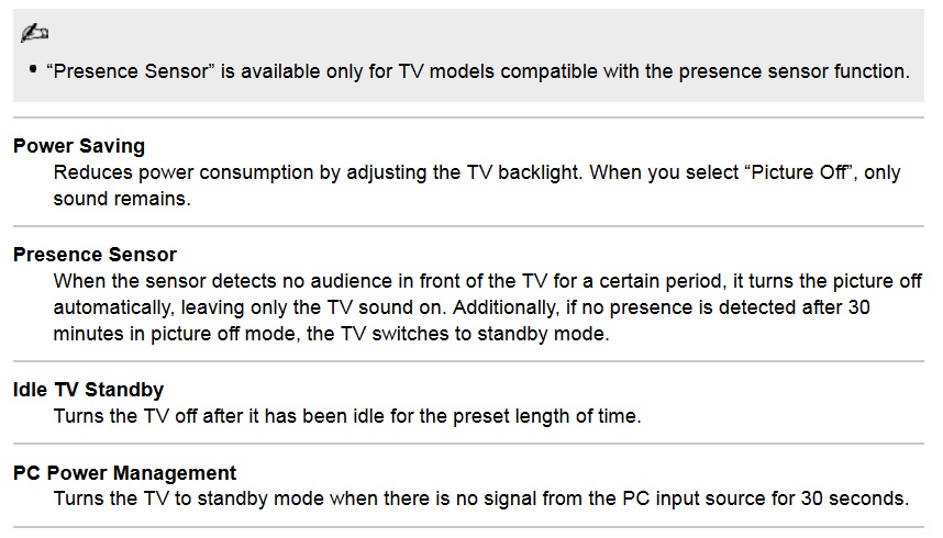

Under the ECO settings, there is an option for PC Power management - But only from the PC input Source (ie VGA). There is no option to power down the TV from any other input source.

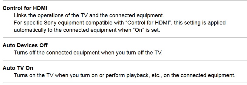

Looking at the HDMI settings - Even IF the PC was compatible for HDMI-CEC functions (Bravia Sync) which it probably isnt, there is still no way to switch the TV off. You are able to have the TV switch itself on via a compatible connected device, but not the other way around.
Your only option is the Idle TV standby setting/presence sensor (if available) but they have some drawbacks if used too.

Im not sure what you are trying to achieve here. However I am not aware that you can automatically turn the TV off over HDM if no HDMI input source is detect.
Have you looked into the ECO settings in the System Settings - In particular "Idle TV Standby" or even Presence Sensor.
http://pdf.crse.com/manuals/iManuals/egb/3a-1/eco_2b1_2b2_3a0_3a1_3a2_50.html
